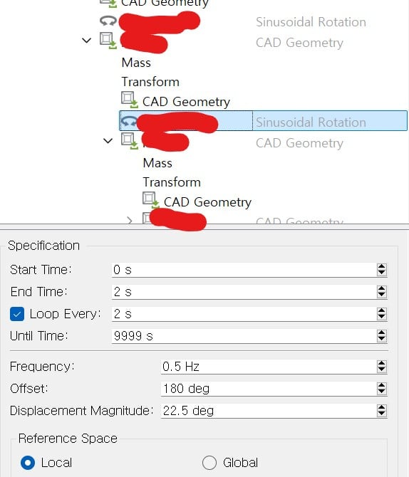

I Made the link in the hyperstudy
and checked the number changed in doe
But after simulation the linked sinusodial Rotation didn't changed in the EDEM
How Can I fix this problem?
Hi,
I checked using 2024.1 and i'm able to change the displacement mangnitude OK. Can you try unlinking the variables and confirm if the variables you want to change get modified without the links.
This will then help confirm where the error is.
Regards
Stephen
