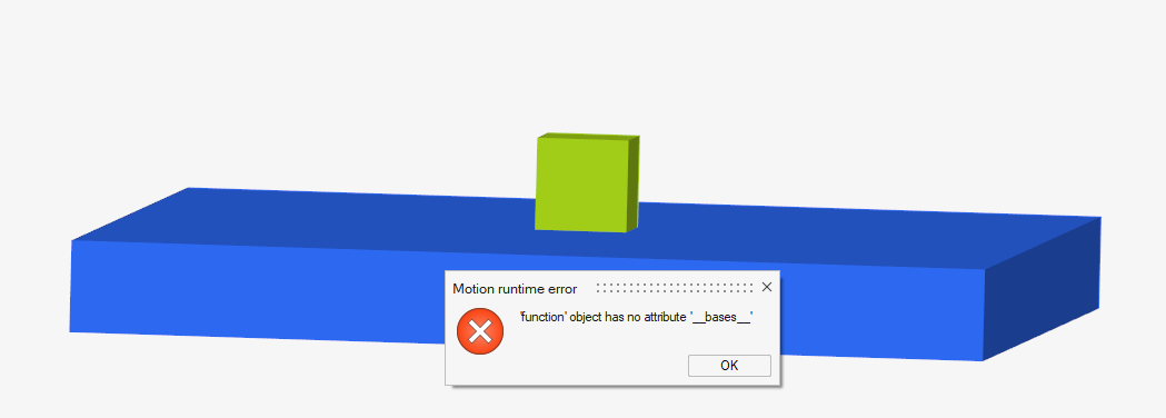

Following error message window pops up after the initial 0.5s:
Motion runtime error
'function' object has no attribute '_bases_'
