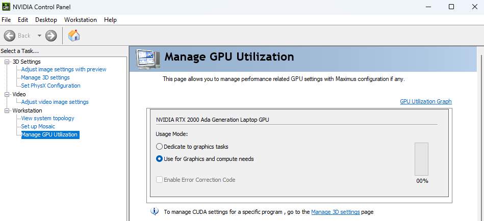

    5. Change graphic card settings from "Optimize Graphics Performance" to "High Performance"
      1. An issue can arise on Windows laptops equipped with AMD or NVIDIA graphics cards when the application’s performance setting in the graphics card software is configured to "Optimize Graphics Performance."
      2. Please change the graphics setting for icad or MSEmbed to 'High Performance' in your graphics card's software settings.
