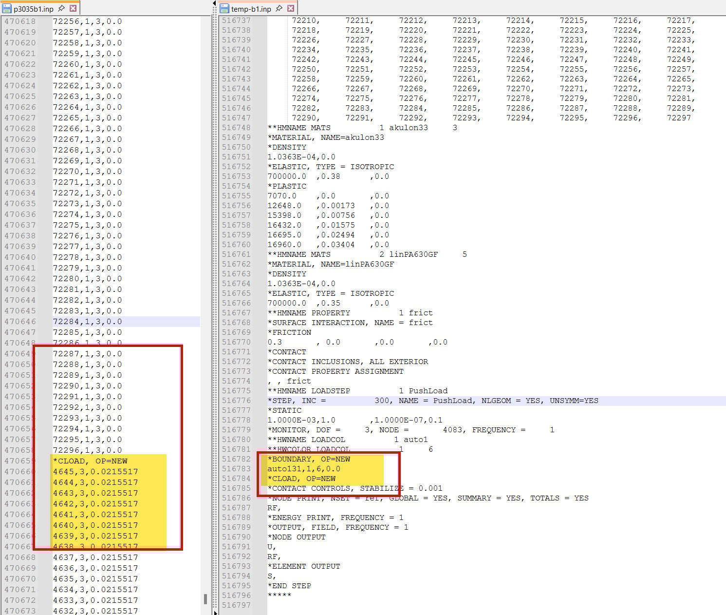

    I am afraid that for security reasons I am not sure I can share the files. But, I just created the BCs from the menu below, shown in the photo.
    As I mentioned, once I close the file, when I open it again, some BCs are deleted or changed.
    First picture, what I originaly created, second, what appears when I open the file again.
    Thanks!

    Since you can't share your model, I would make sure you are looking at the input decks. That is true way to verify. Visually what I see is the difference between legacy loads and the new migrated loads. No loads should be changed or deleted.
