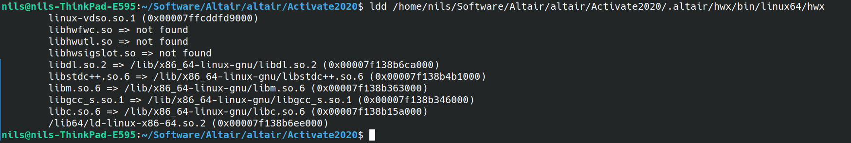

I was trying to run activate on Kubuntu 21.04 but I got the following error message:
Furthermore I looked up if there are any shared libraries missing:
best regards

Hi Nils,
Officially Activate is released for Linux RedHat/CentOS 7.4 and SUSE 12 SP3. Other systems may not be supported. It will be best to ask someone from the developers ...
And please let us know what you have learned.
Best
Ok,
I had some chats with the developers and so far there is no Activate version for Debian based Linux distributions planed.
