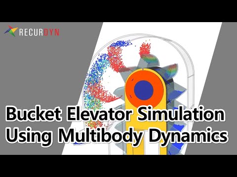

I have tried creating a Pulley belt on MotionView and coupling EDEM, but this method takes a lot of computation time. I hope the calculation will be fast and the motion movements are set up entirely on EDEM. Do you have any comments about this issue? Please refer to this link:
https://www.youtube.com/watch?v=BI9Bo_aoV5I
https://www.youtube.com/watch?v=WSiMlu3P58w
