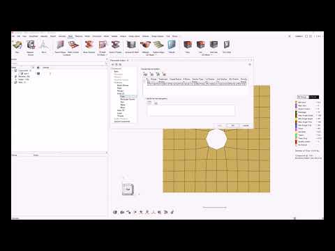

In order to remesh an existing 2D mesh, you can try the Rebuild function. Like the BatchMesher, the Rebuild can seek for geometrical features and generate clean 2D mesh based on your quality criterias.
Please take a look at this docs:
https://help.altair.com/hwdesktop/hwx/topics/pre_processing/meshing/rebuild_mesh_t.htmhttps://youtu.be/i0h6w0v3yzI?si=bFCrkzaGNaEmMmh_
https://youtu.be/l-Vc0VsUw9U?si=3Ms34yMowQkBeSs2
