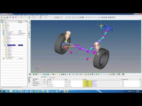

I have some questions related to the Motion View software. The first one is if I can simulate the whole car in this software. The second is if I can simulate ready made front and rear suspensions from the software which I can't find. And the last one is if you have any material so I can learn to use the software.
Hello Tassio - Yes, MotionView has a complete vehicle modeling and simulation tools that comes with the install.
You may refer to these specific tutorials
MV-1032: Build Models and Simulations Using Wizards
Vehicle Simulation using MotionView
