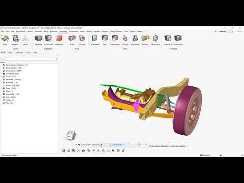

How to check connectivity of my model when dealing with Constraints?
For implicit codes, Model Checker (from Validate ribbon) must be used for checking the model connectivity up to version 2022.2.
From version 2022.3, the Find Attached (can be reached through SHIFT + F5) will include an option to detect attached components even if they are attached through a Constraint.
Starting 2024.1, Find Attached also includes Tie Contacts.
For explicit codes, you can rely on the “Find connectivity” tool available in the Validate ribbon:

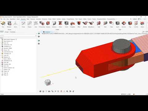

What is the preferred way to create my kinematic couplings?
This depends on what you are trying to model. If your couplings are intended to be part of a connection between several parts (spotwelds, fasteners), then it is better to look for connectors, and to look for the more appropriate connection type.
For instance, constraints are frequently used for fasteners.
 If you still want to create Couplings by hand, you can create them:
  • from Model ribbon in 2022.x versions
  • from Model Browser → right click anywhere → Create → Constraint from version 2023.0

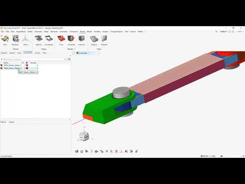

How can I review my constraints?
If you want to do the same as in the legacy interface (show, hide, isolate), you can use either the Constraint browser, or the idle bar top left in the graphic area and hide/show/isolate some constraints.
What if I want to review the constraints associated to displayed components/parts?
When you show some specific components/parts in the graphic area, you may want to show only the Constraints which are related to your displayed parts. Form 2022.3, you can use Find Attached to review them.

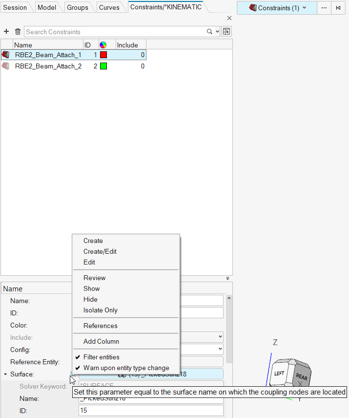

How can I edit the nodes of my constraints?
As we are getting closer to the solver definition of these entities, we are creating and exposing the node set when setting up the coupling.
The quickest process now for editing the entities belonging to your constraint is to go into the browser, then right click -> Edit in the empty space left to the set name to update your selection.

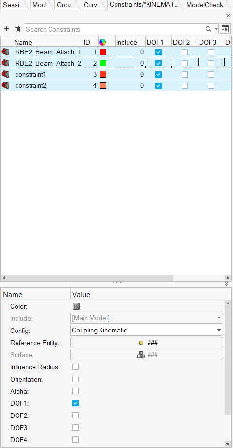

I am still using the classic interface or HyperMesh. How do I show/hide constraints?
 You can show/hide Constraints and edit their attributes from the Model browser.
