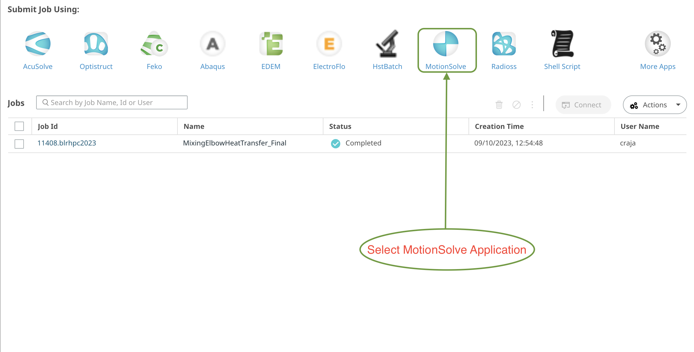

  • Step -1:Login to Access Job submission web portal and Select MotionSolve Application Icon.
  • Following image showing the same:

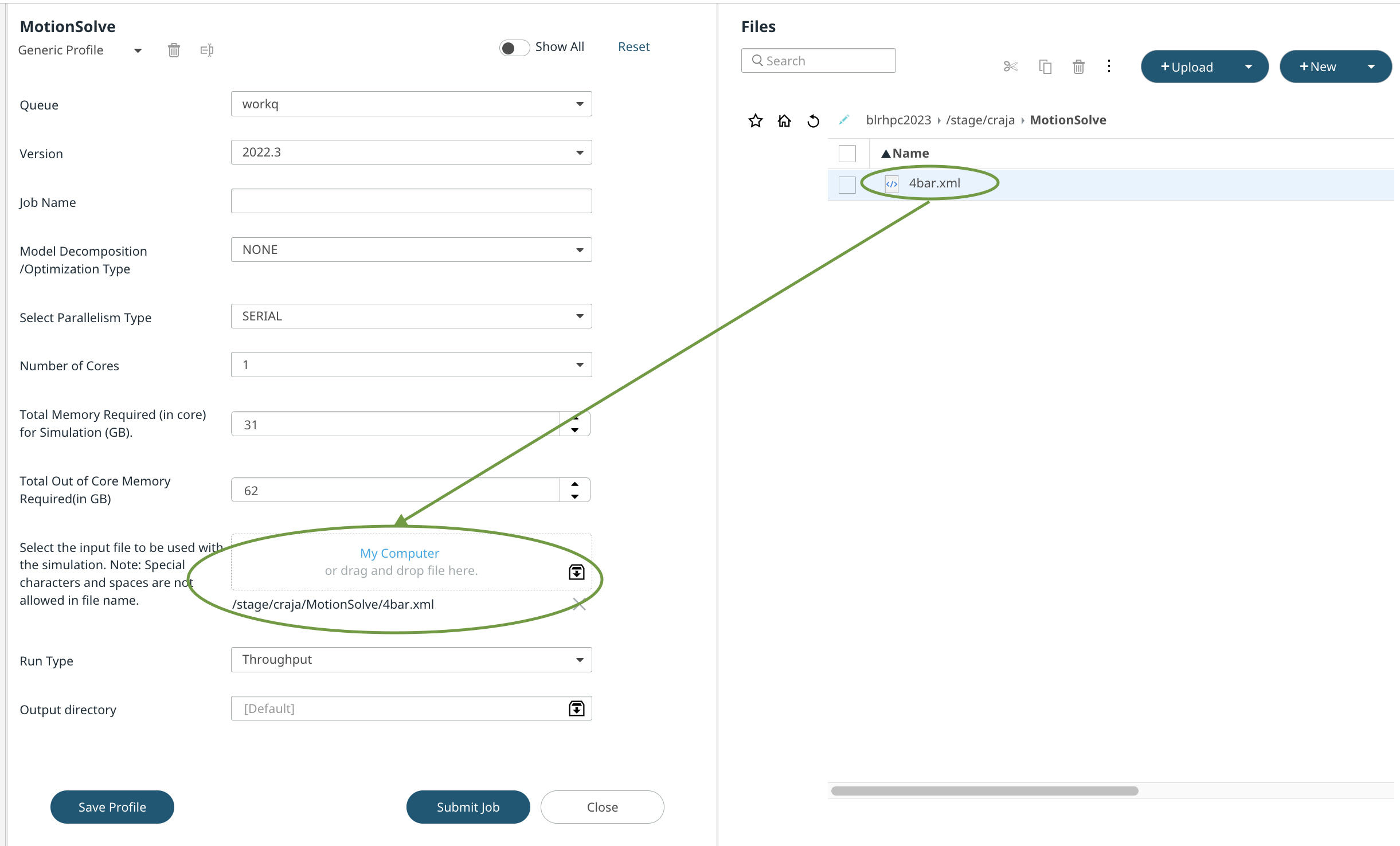

  • Step -2:Drag and drop input file(.xml or .zip(where the .zip should contain the .xml file) at (input file form) field:
A screenshot of a computerDescription automatically generated
Field Name
Version
MotionSolve application Version to run the job.
Job Name
Job Name / Default is input filename excluding extension
Select Parallelism
Explained below
What is input form field “Select Parallelism Type”?
  • SERIAL – To run the job using single cpu core. Ideal for one node one core job.
  • SMP – To run the job using more than one cpu core and less than or equal to the cpu cores in one compute node. Ideal for SMP supported application to run in single node.
Field Name
Number of Cores
Select Total number of cores required for job.
Total Memory Required (in core) for Simulation (GB)
Total amount of memory required for the job.
Total Out of Core Memory Required (in GB)
Total scratch disk space required for the job.
Input file(.xml or .zip)
Primary input file for the job where you can submit the files in the form of .xml or .zip(which should contain the .xml files for sure)
Run Type
Performance - If all number of cores in node is not allocated for this job, Remaining cores will not be allocated for other jobs.
Throughput – If all number of cores in node is not allocated for this job, Remaining cores will be allocated for other jobs.
Output Directory
Directory name to copy back all job files. Default as per site specific configuration

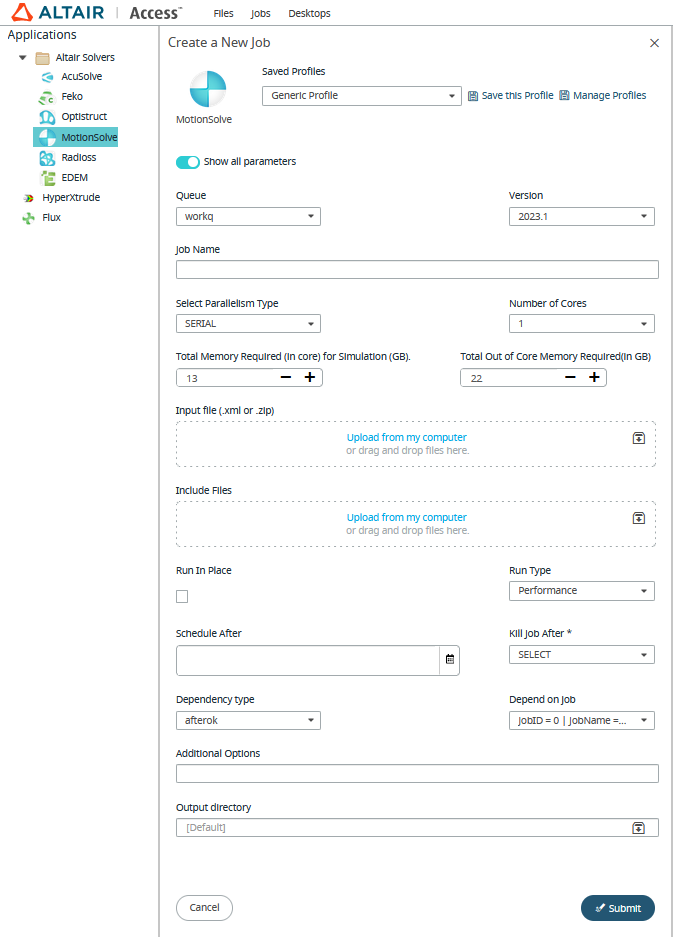

  • Following image showing when we are Enabling show all option:
Apart from default Additional form fields are visible here, Following are the additional form fields other than default form fields:
Field Name
Default
Run In Place
Check this box if you want to run your job in the same directory where your input file is. This will prevent the expensive file copies. May impact performance of the simulation.
User selectable reasonable default: False
Include Files
Select the include files to be used with the simulation. Generally, the include files are auto added. But this is only an assist feature. Please ensure all the necessary include files are added and available before submitting the job.
Schedule After
Select this option to schedule your job to run at specific time in future. Note that the job becomes eligible to run after the selected time. Actual start times may differ based on the resources available on the cluster.
Kill Job After
Specify the estimated time that your job is expected to run on the cluster. Providing a good estimate increases the chances of your job starting sooner.
Note: The scheduler will kill the job if the actual wall time exceeds the estimated time specified.
Dependency type
Specify the Dependency Type:
afterok: start the current job only if the specified depend job is successful.
aferany: start the current job after the specified depend job irrespective of exit status.
Default: afterok
Dependent on Job
Specify the job id of a previously submitted job after which the current submission is expected to run.
Additional Options
Specify any valid command line options that you need to pass to the application. The options will be passed verbatim to the application.
