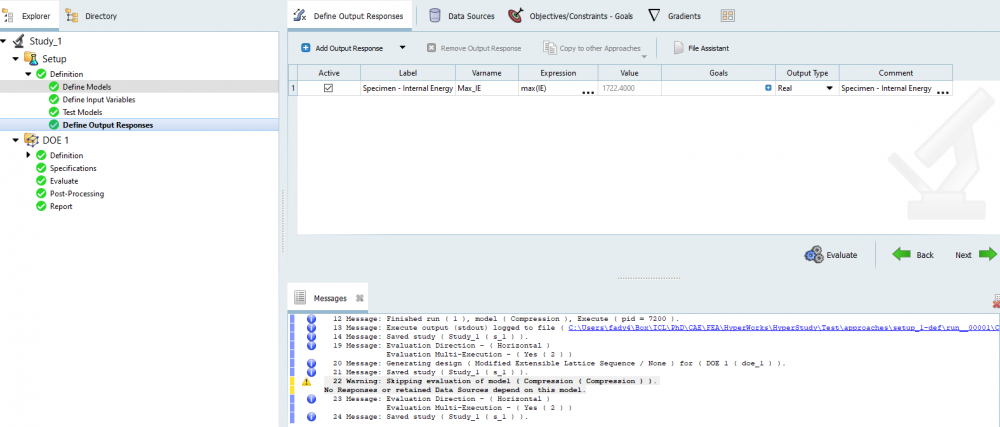

Hi,
I have run a succesful setup with LS-Dyna and extracted the responses correctly,

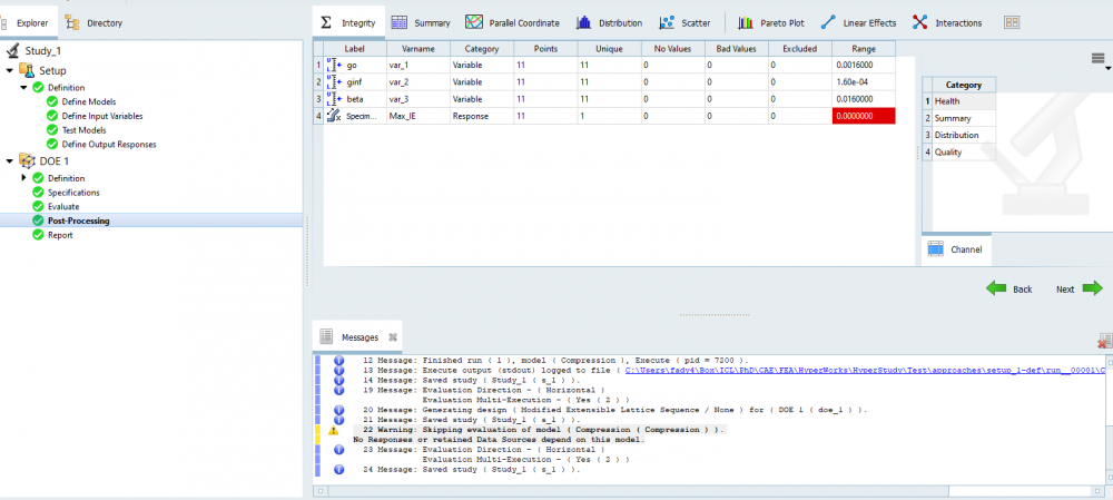

However when I run a DOE it succesfully evaluates however the runs of the DOE are skipped, it goes through them quikcly and I get this warning:
85 Warning: Skipping evaluation of model ( Parameterized_k ( Parameterized_k ) ).
No Responses or retained Data Sources depend on this model.

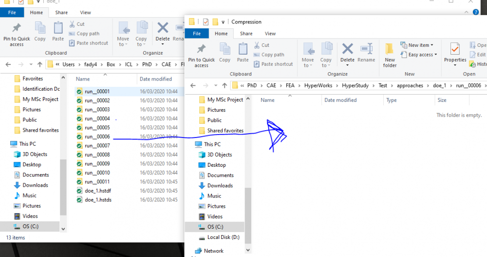

I am not sure why it does this as I am sure my response is referencing the correct file. s\HyperStudy\Test\approaches\doe_1-def\run__00001\Parameterized_k\matsum
The doe file has all the run000 folders but they are all empty.
Any help would be appreciated.

Fady,
I have had this issue before. I can usually fix it by deselecting and reselecting the check boxes under 'define models'. That is, DOE1 -> Definition -> Define Models. This will also make all the input variables as active, so if any of them were inactive, you will have to uncheck those boxes again. Hope this helps.
