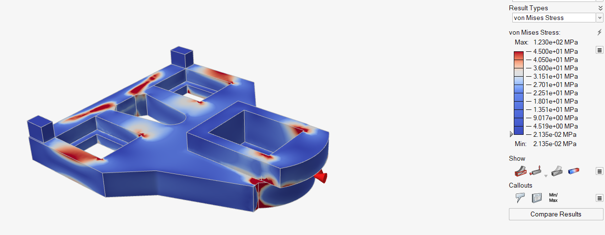

    Hi!
    I could reduce mass by 25%, from 24g to 18g and also I reduced the cleat height from 13mm to 12mm (which is not much :c but still works) , resulting on this shape: image
    It also reduced maximum Von Mises on the combined loadings case from 172MPa to 103MPa, which results on the piece having more strength against the maximum loadings.
    Optimized piece stresses:
    Old piece stresses:
    Thank you!

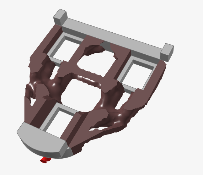

    Hi,
    So I run some tests to optimize the structure, but it was not so easy to take something away. From the start model, it already bends 1,6 mm and von mises goes over abs limit (105 MPa). There was no mention about changing the material, so I stuck with abs.
    Here is my optimize result:
    So this is my result:

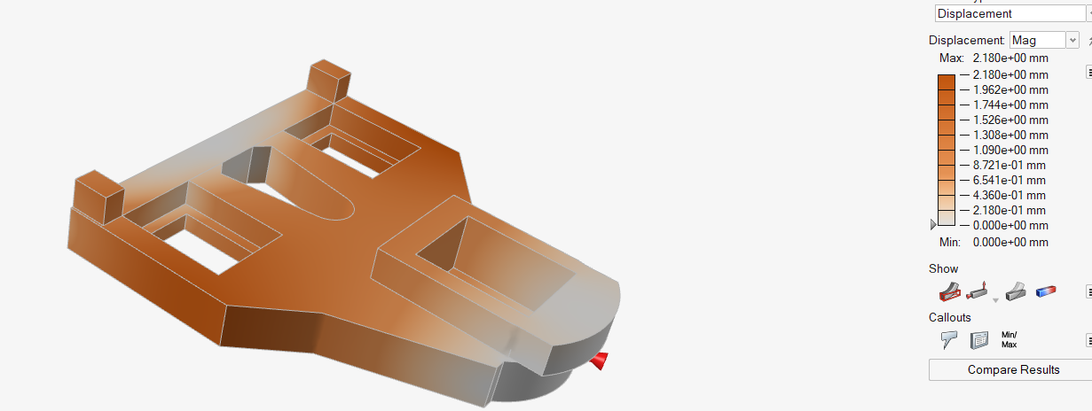

    I got max displacment 2,18 mm and max von mises 123 MPa. The weight is now 21 g
    PS.
    I can’t understand how other have manage get rid of some much material and even get better stiffness.
