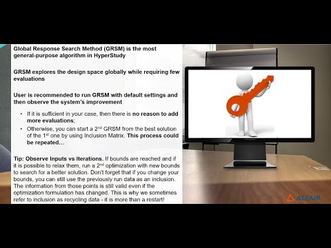

Hello HyperStudy Users,
GRSM is a powerful optimization algorithm that can be used to find the best design for a variety of engineering problems. It is particularly well-suited for problems with a large number of design variables or multi-objective optimization problems.
Please check this video about good practices in using GRSM.
https://www.youtube.com/watch?v=Jt1pYKyGF0M
