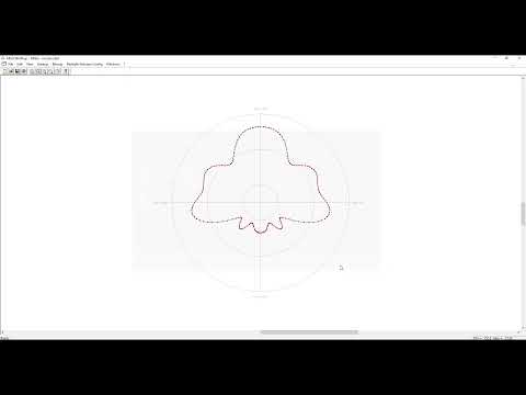

  • Conversion from 2x2D pattern (horizontal and vertical) to 3D pattern
  • Graphical editor to define manually vertical and horizontal antenna patterns (drawn with a mouse while having a scanned bitmap of the pattern as a background image)
In this blog, we will focus on converting 2X2D antenna patterns to one 3D radiation pattern that can be accepted for ProMan simulations. The radiation patterns in the horizontal and in the vertical plane are available for nearly all commercial antennas, whereas full 3D patterns are not always available as they are more complicated to be measured. AMan offers four different conversion algorithms. The user can decide which algorithm should be used.
  1. Arithmetic Mean (AM) Algorithm
  2. Bilinear Interpolation (BI) Algorithm
  3. Weighted Bilinear Interpolation (WBI) Algorithm
  4. Horizontal Projection Interpolation (HPI) Algorithm
It is recommended to refer to the user manual for details on each of the above algorithms. A complete section of the user manual is based on numerical evaluations to test the accuracy of the above algorithms.
The detailed steps  to convert 2x2D patterns to a 3D pattern are demonstrated in the attached video. Please reach out to Altair support for more details and questions.
https://www.youtube.com/watch?v=5pFXtVYEm_k
