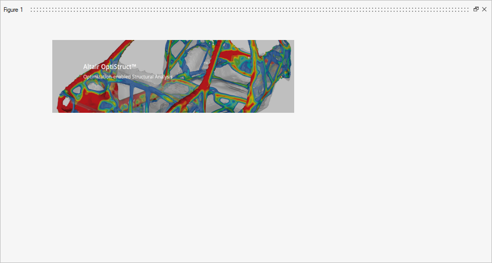

    Once you create your figure that will receive the uicontrol entities, you could set the position of the external image with position property.
    An example:
     img = 'OptiStruct.png';  figure(1); myimg = imread(img); imshow(myimg,'units','normalized','position',[0.1 0.1 0.5 0.3]);
    And the output is:

    This is exactly what I wanted to do. Many thanks Roberta.
