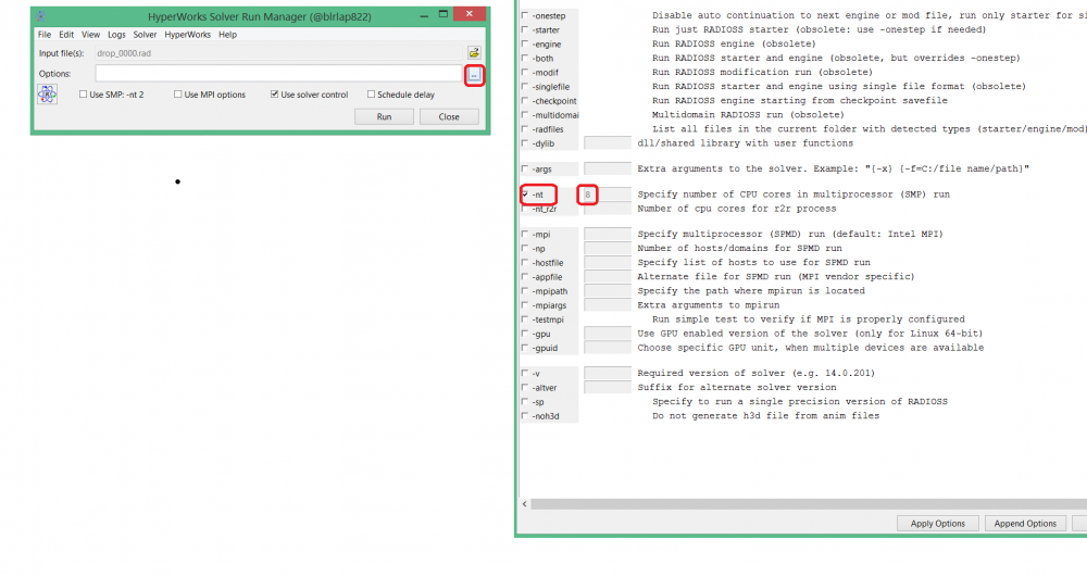

Hi, is there a similar way of doing it with RADIOSS? do you have any example on how to type the -nt command into the Solver Input Arguments?
THanks
Hi,
You can specify the number of cores in the RADIOSS solver run manager. Please go through the 'Run Options in RADIOSS' in the Help Menu.
