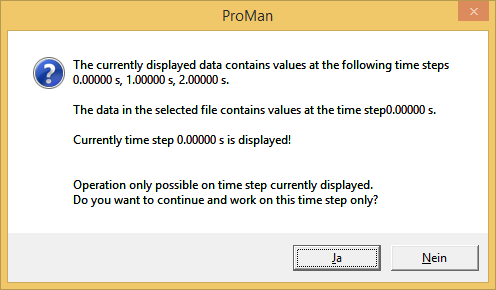

- I tried to view the 4D prediction to confirm whether the models and transmitters are exactly identical. However, my ProMan hanged responding very very slowly.
- I also tried to export results and compare, However the time variant simulation's ASCII file is huge (~700-800 MB). This could be because time variant model is exporting data for all time instances.
Please advise if there is a way I can find out the reason for differences am observing between time variant and non time variant (exactly identical to time variant) ProMan simulations.
One way to understand this is to find out if we can extract data only for the single time instant and/or if we can 3D view to compare the prediction plane (time variant and non time variant simulations) without ProMan hanging.
