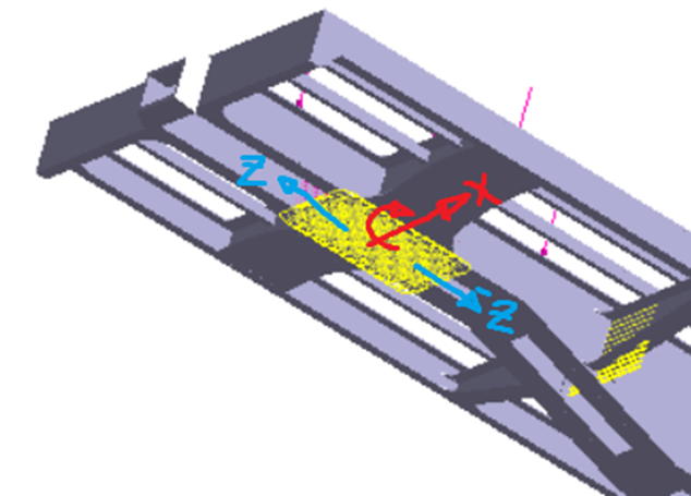

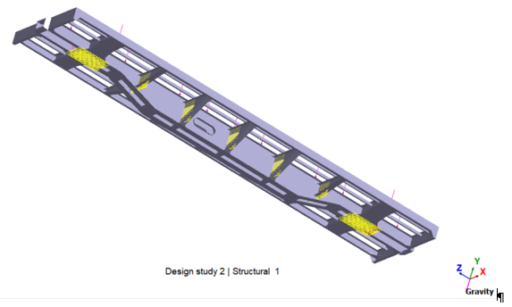

This is a underframe of a freightcar:
and I would like to know how to apply a constrain that only allows the rotation un la X axis and the displacement in the Z axis, like this:
I have tried applying "Slider Support" but this do not allow the rotation in X axis.

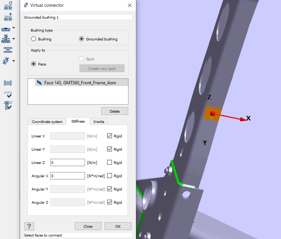

virtual connector - grounded bushing with all bushing stiffness rigid except rotation about x and translation z with stiffness = 0
