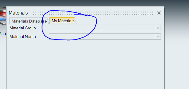

Hello C2C experts,
I am doing casting simulation with carbon steel material. But I found only 2 types: AISI-1008 & 1026.
Could you advise how to do if I want to simulate AISI-1030?
Thank you.
Dear User,
If you know the properties (physical and Mechanical) of AISI 1030 which is high carbon steel , you can substitute the values and create your own material.
