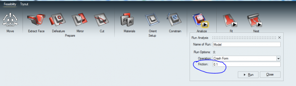

But I cannot found where and how to input cushion force in IF.
Same as for Friction parameters in IF.
Any comments and advice are very much appreciated.
Thank you coud
you can choose Friction option In Feasibility tab (as below image). But in Tryout tab you can not use friction option. (not include in Tryout)
