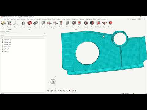

    Hello @ATLURI BHARATH KUMAR ,
    are you looking for washers for 2D mesh or ofor 3D mesh? If you are looking for washers for 2D mesh, then the state of the art method in HyperMesh (either classic or new interface) is the batchmesh/QI optimize, with the use of param and criteria file:
    https://youtu.be/RaGIyKehFdY?si=U2yE31rq88xOMxw2
    This will prevent you to create washer lines for each hole.
    Best Regards,
    Michael
