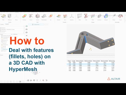

Hello @ATLURI BHARATH KUMAR ,
if you are using the new user interface (which I would recommend), you can use Features to auto-detect holes:
https://youtu.be/eoUtpJlOP3U?si=GxP7oW3p5tYvo9Nf (from 18:36)
