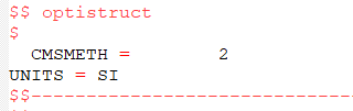

As I suspected, the UNITS card was not being written correctly, (the value 'SI' was not being written), I recreated the UNITS card and it worked ok
my HM file attached (v2022)
Alternatively, if you edit your .fem that you write out and add the 'SI' as below, then the model will run
