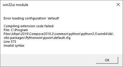

Hello,
When I load the Python command window in v2019.2 of Compose, I get the following error when typing help('modules'):
Although this error pops up, I am able to see the installed modules when I hit OK. But why is this error happening? How to avoid it?

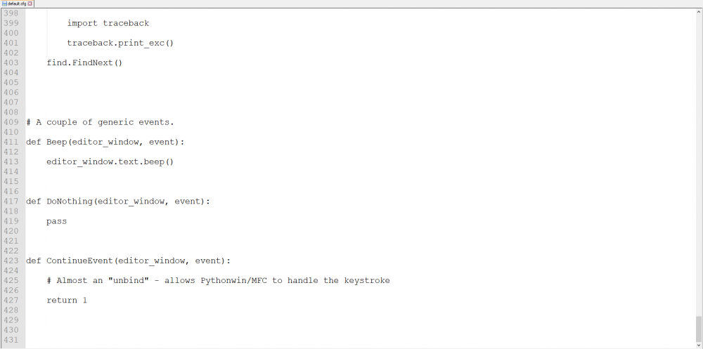

    The error message does not have any ^ operator pointing to the exact position where the command fails. It seems like some kind of installation issue, since I didn't even spontaneously call this function, but I'd like help to understand what exactly it is.
    On top of that, the line 575 that the error mentions in file default.cfg does not it even exist, because this file only has 431 lines:
    <?xml version="1.0" encoding="UTF-8"?>image.thumb.png.a5bf478ec47f40279e5075dc539d6a7d.png
