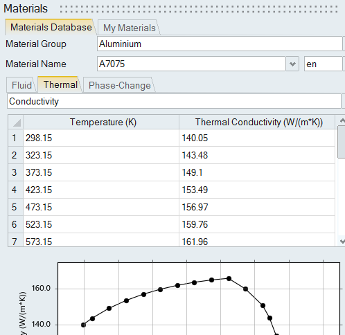

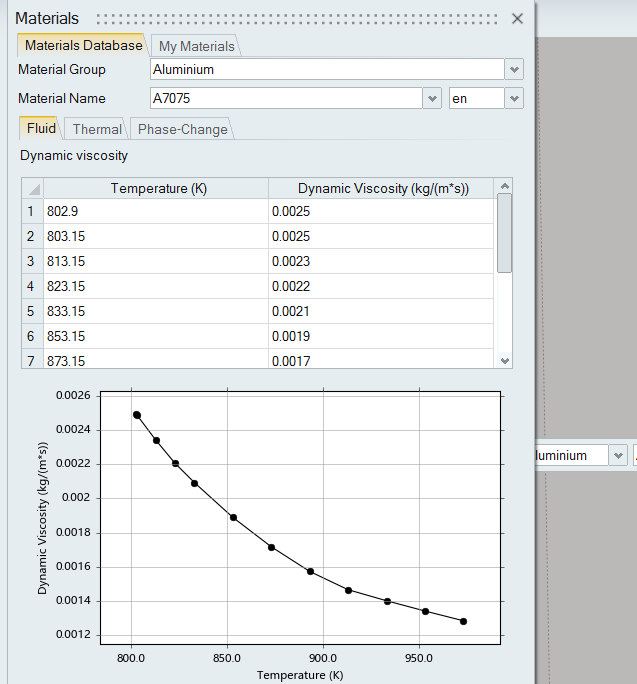

Hello,
I am currently working with a custom Aluminum alloy and need to input custom thermal/mechanical properties as a function a temperature. Is this possible and if so how do I define and import a custom material in inspire cast?
Ryan
Hello User,
you can input your values manually in the Material Database or My database and manually input your values.
