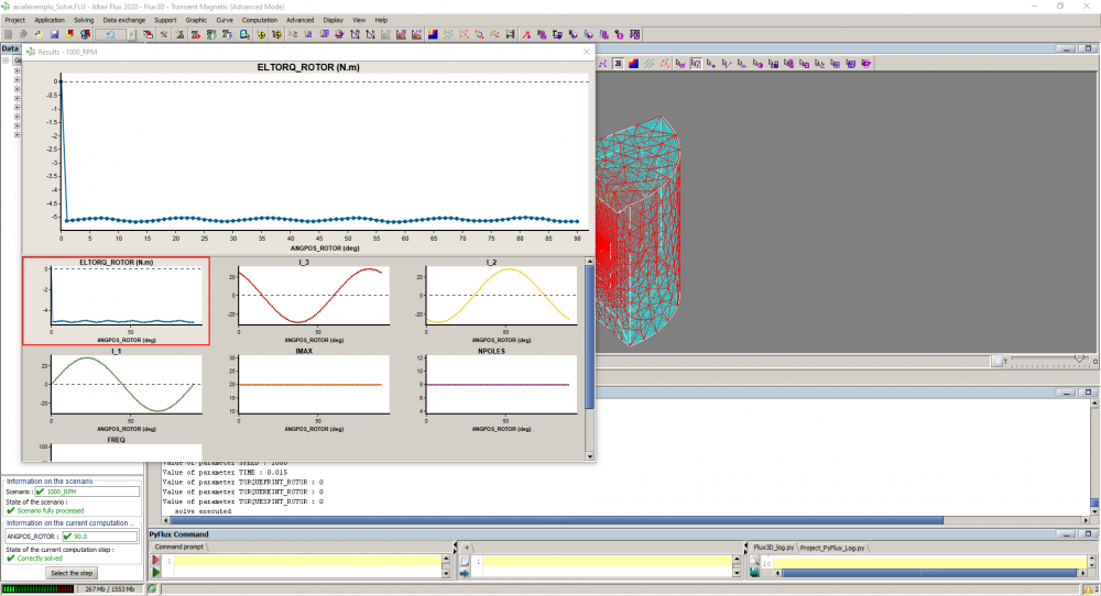

I have the same result as Abdessamed.
I have solved you device in Flux without any issues (with Altair Flux 2020)
Can you tell us which version of Altair Flux you are using and which linear solver (Direct or iterative) ?
<?xml version="1.0" encoding="UTF-8"?>
Thank you very much. I only needed to have the result of the torque
Attached the solved project.
