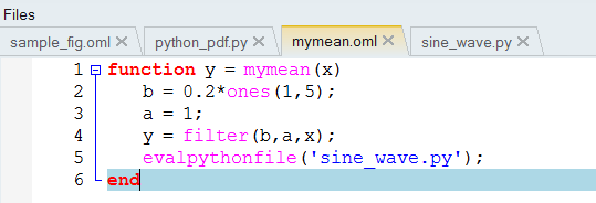

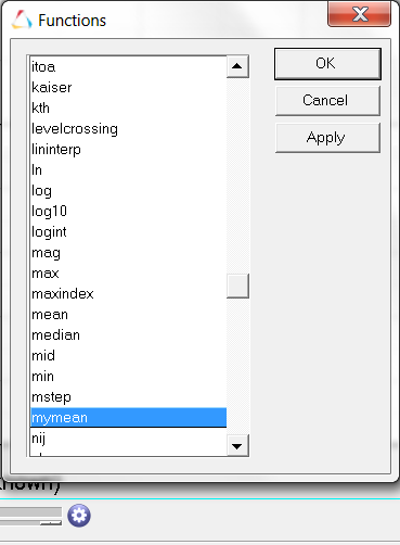

I created a function mymean which executes a python script which plots a sinewave. I was able to register the function and could find it among the registered functions in hypergraph.
<?xml version="1.0" encoding="UTF-8"?>

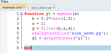

I think you are right. I tried the following script which evaluates the values of a sine wave in compose python and retrieve back its values in a variable in oml side. This is not found to be working in Hypergraph side.
Step 1: I registered the following function in Compose which returns the values of a sine wave computed in Compose python.

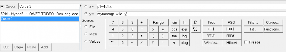

Step 2:

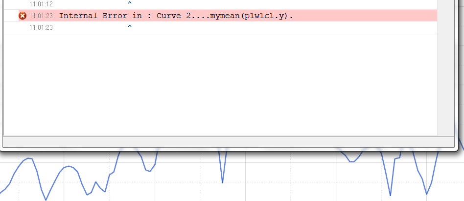

I created a plot using the ANGACC file available in tutorials folder. When I tried to create a new curve based on the ANGACC plot and mymean function, I am getting the following error in Hypergraph. So I think we dont support registering functions which includes python bridge capabilities.
Thank you, Sijo! After an exchange with the development team, they confirmed that this on the plan for 2019(.1)
