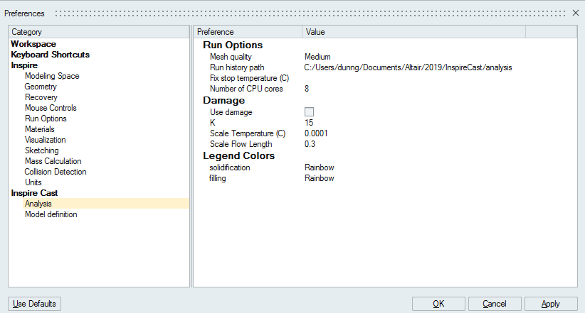

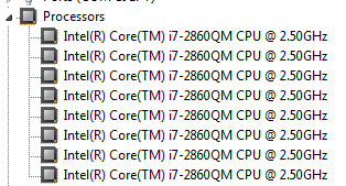

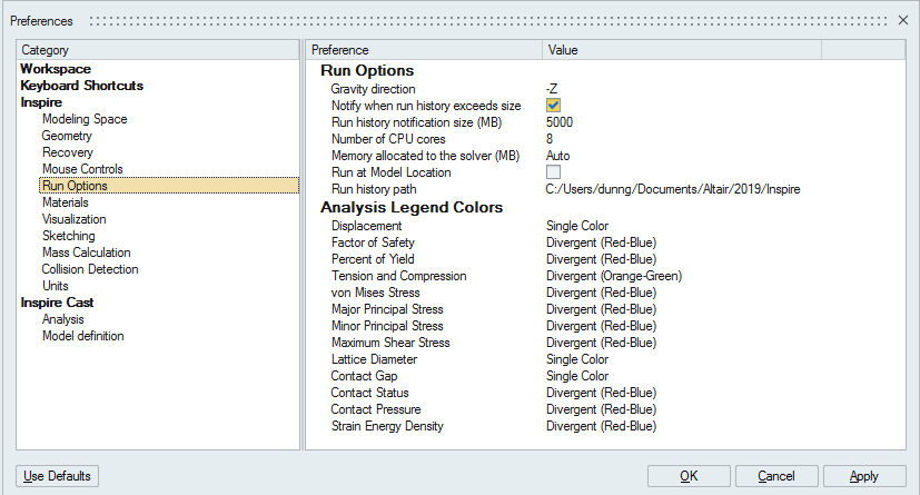

Hi everyone, I have a problem with Inspire cast. It takes too much time to solve a tutorial model, although i set up the number of CPU in preference like this.
Thanks!!!!

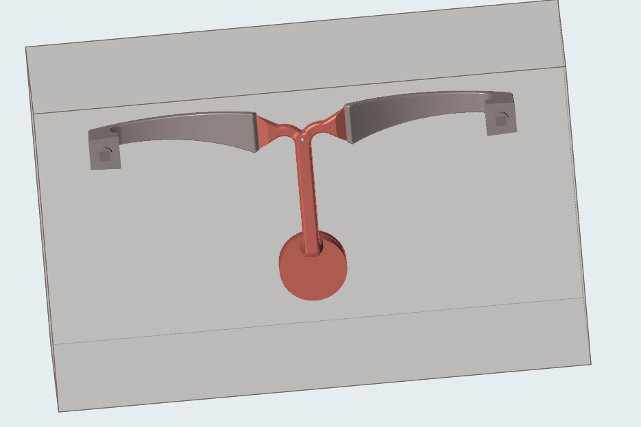

Hello Matthieu,
Here is the tutorial that i'm doing
It takes about 6 hours but has not completed yet although I did exactly steps and filled accurately parameters in the tutorial. Thanks.
Something is wrong in your setup that causes the solver to take a very long time to converge. On my machine it takes 5 minutes to solve on 4 cores.
Hi, When i used Inspire cast 2019, it took too much time to solve the problem, but when i used v2018.3, it took 15 minutes to solve this problem. And i assure that i set up the problem exactly like the tutorial.
Thanks.
It takes more or less the same time for me on 2019.
