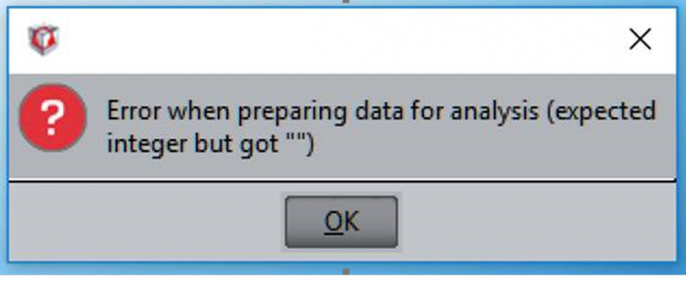

When starting calculation, I get an Error message see attached

Hi Uri,
This problem appears when the ingates are not well set. It looks like this is a second iteration of an initial simulation, maybe during the second selection of materials something got corrupted. When this happens I recommend to start again the simulation from the original stl creating a new project.
Please find attached a simulation ready to run, please check the parameters are fine and run the simulation again.
