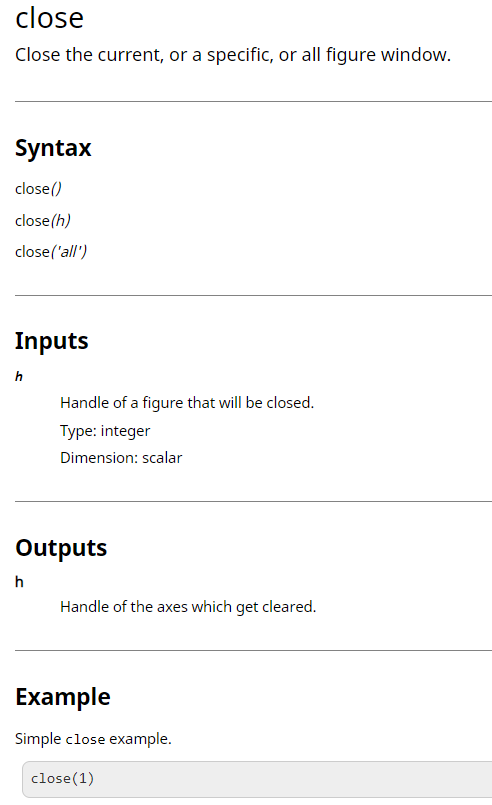

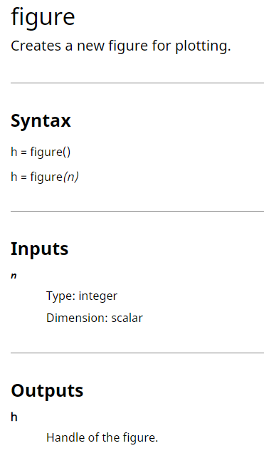

Is your goal to close plots that were created within an OML script in the system model? If so, the command close(figure_handle) will close a specific plot.
The handle ID is obtained as output from your figure() command which generated the plot.
