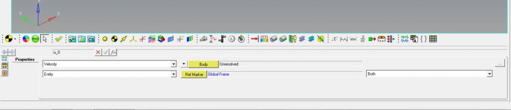

For velocity and acceleration or any other desired output entity you have to create output first
from that output property panel you can select on what (body, joint, bushing etc) you wanted to find velocity and acceleration
And after simulation you can view velocity and acceleration

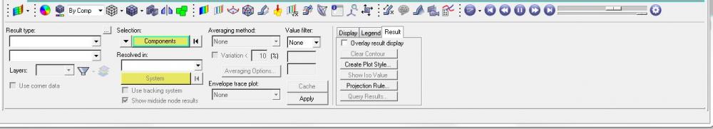

i have tried this option but there is no output available in post processing
there are all empty outputs

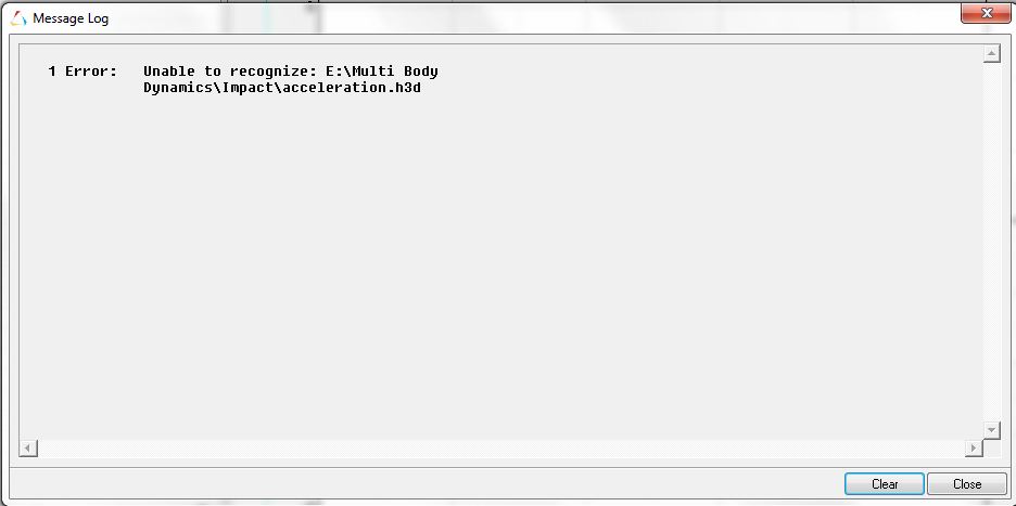

i have tried to open that file but there is some error message that it is unable to recognize
please share your entire message or screenshot if available
this error message
OK
This message indicate you are trying to open different file format
For Post-processing in HyperView you can open .H3D result file (H3D graphic file is different in motionview)

Do one thing create output as velocity in your MotionView file and save it in another folder
Run your simulation and open HyperGraph and open .plt file
In this .plt file you can view your specific values of output
yes it is working, but for other outputs like displacement etc do we need to create another output request??
yes krunal,
you have to create another otuput request for another entity like Displacement, force etc
if you want output on different joints you have to create different output request
(If you have three joints and you want two output velocity and acceleration you have to craete three output request of velocity on each joint and three output request of acceleration on each joint so you create total six output request)
