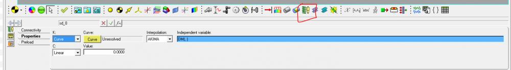

Sir, Can you suggest me how to model suspension system whose stiffness changes according to deflection happened in motion view. I have the graph of changes in stiffness with deflection .
You can create spring with type as curve in MotionVIew
sir, How To put it as spring force vs deflection or spring stiffness vs deflection.
HI,
Create the curve in MotionView, create the spring next and in properties, you can define the stiffness using the curve.
<?xml version="1.0" encoding="UTF-8"?>
sir, what should be the independent variable. In my curve x axis is displacement and y axis is stiffness . How to give displacement as the independent variable?

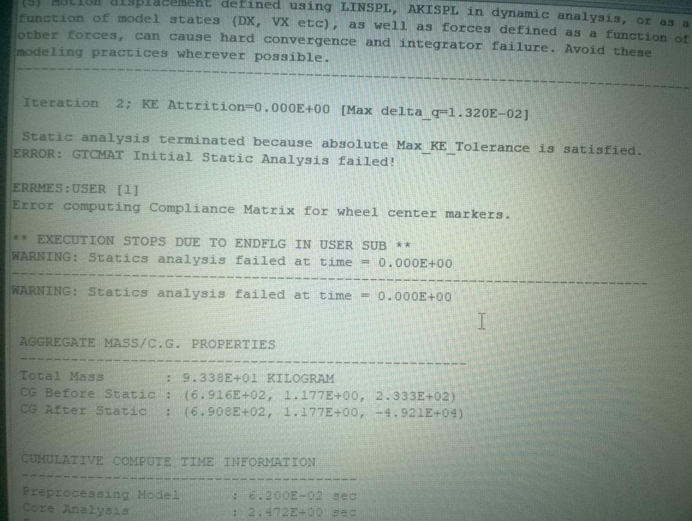

sir . I am not finding out this error can you please check it .
Looks like there is some modeling issue.
Can you change the MAX_KE value and check if that helps. You can change it in Run panel>> simulation options.
sir, can you please tell me what is the modelling issue?
Sir , I added MF/SWIFT tire in auto entity but it is showing ' the non linear system solver in the time integration could not converge ' if I perform dynamic analysis
