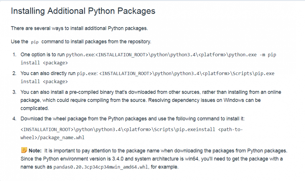

Installation of packages other than those you have mentioned in your query can be done using the details given in the installation path of Compose. The installation path is given below.
@ C:\Program Files\Compose\2017.3\help\Compose\topics\compose\installing_python_packages_compose_t.

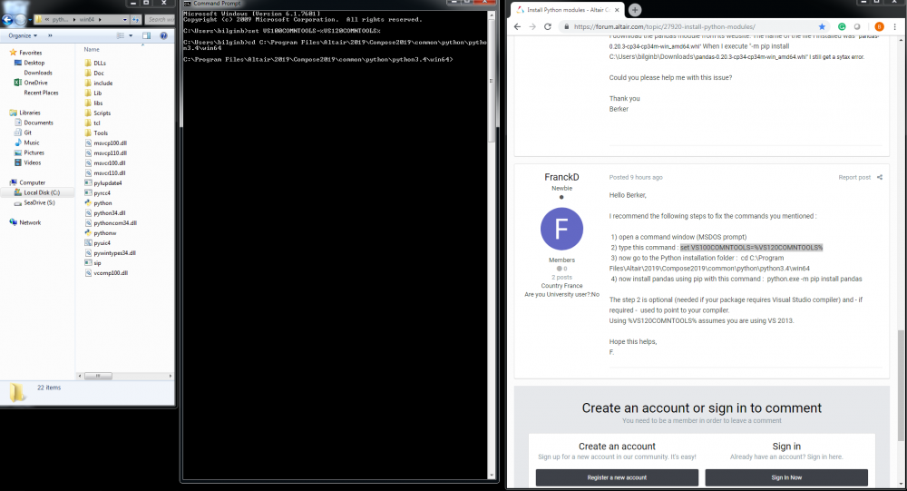

Thank you very much for your response. I applied the steps that you suggested.
In the command prompt, I typed the command set VS100COMNTOOLS=%VS120COMNTOOLS%
It did not give me any error.

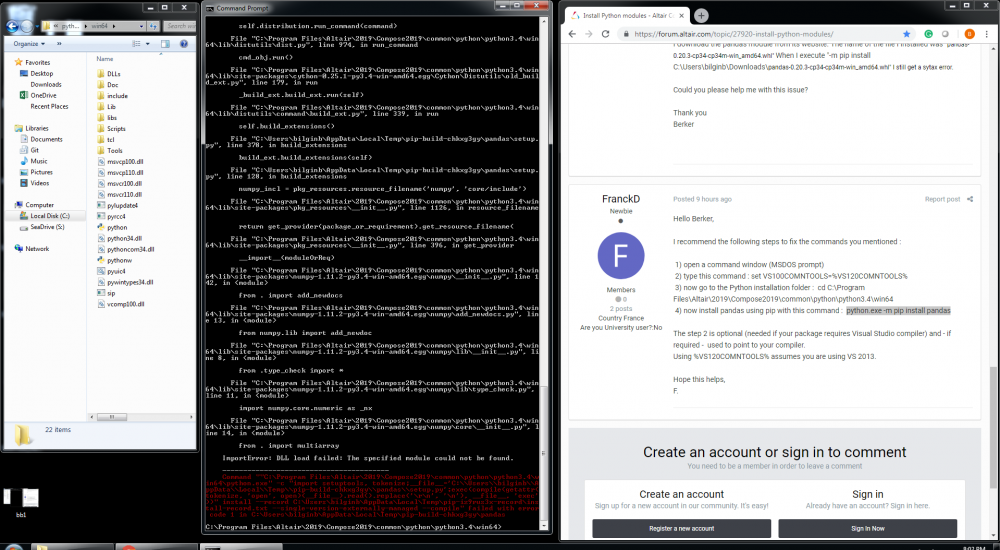

Then, I switched to Python folder in the command prompt as you instructed. Please see the attached screenshot bb1.

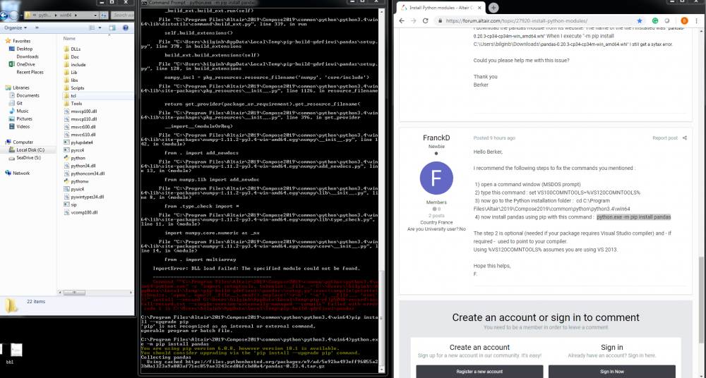

Then I executed the command 'python.exe -m pip install pandas' in the command window. It tells me that I have an early version of pip (see the attached screenshot bb2). But it seems that the installation worked fine (see the attached screenshot bb3).
However, after the installation is completed, when I run the command import pandas as pd in the Python Window in Compose, I still get the same error: ImportError: No module names 'pandas' I restarted Compose and then restarted the computer, but it didn't help.
Do you have any suggestion for how I can find the reason of this issue?
Thank you
Berker

Hi Berker,
Actually in your screenshot 'bb3' python did not succeed to install Pandas.

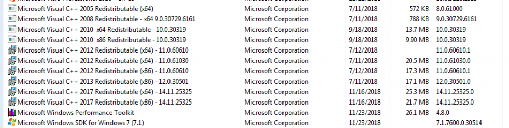

I have tried many things to resolve this issue. I installed Microsoft Windows SDK 7.1. I ran the same commands from Windows SDK 7.1 Command Prompt. But I am still getting the same error. I have many Microsoft Visual C++ versions on my computer. Attached you can see the list.
I checked the online forums. Some mention set VS100COMNTOOLS=%VS140COMNTOOLS%, which I already applied. Some suggest having Visual C++ redistributable, which is already installed. Do you have any other suggestions to solve this issue?
Thank you
