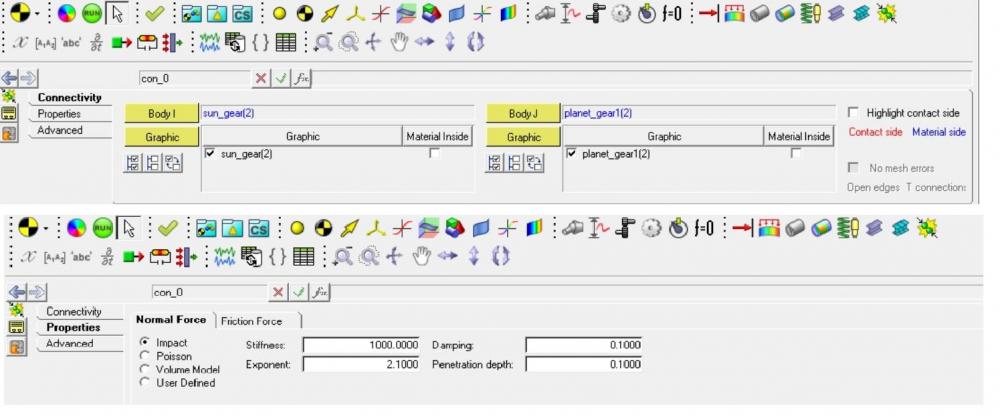

Dear Sir/Madam'
  I have been trying to do a motion analysis required for a problem statement which is required in AOC-2019 contest. While I have tried a lot but every time I am facing 1 issue repeatedly in creating 'Contact' by '3D Rigid to Rigid Contact'. Every time I try to create the contact between two gears, while solving it says 'ERROR: Contact graphics undefined for contact force [id=301001]!'.
 I have defined the bodies and selected their graphics also but it still shows the error. The image of the selections can be seen in the attachment. Kindly help me to solve the issue.
Regards
Pritish Shubham

    Hi Pritish,
    To help you in debugging this, can you provide some more information:
    1. From the error message you post, it looks like MotionSolve is not able to determine the geometry intended for contact calculations in Force_Contact/301001. I assume you are able to successfully export the model from MotionView before starting the simulation?
    2. In the XML model that is exported from MotionView, can you ensure that in <Force_Contact> id = 301001, the following two attributes are defined correctly i.e. pointing to the right graphics statement:
     <span style='color:#0000ff;'>i_graphics_id</span>
     <span style='color:#0000ff;'>j_graphics_id</span>
    Finally, are you able to share the model for us to take a look?
    Thanks,
    Tanuj

    Dear Tanuj
      Thanks for replying to my query. I had tried checking the .xml file and I can see the force_contact had 'i and j' well defined. The image and the .XML file can be seen in the attachment.
    Regarding the model sharing option, I really wish to share it, but I am afraid I am not allowed to do so. Its a problem from AOC-2019 contest, so I don't know whether I can share the problem here. But I will try to discuss it with the concerning person and seek permission for it, if possible before sharing the model here.
    Regards

    Thanks Pritish. As Praful mentioned in the last comment, please share the MotionView model for this simplified model with him or on this forum so we can investigate the root cause of the issue you are seeing.
    For now, based on the XML that you shared, the root cause seems to be a missing Graphics model element for both your gear geometries in the MotionSolve XML file. If you look for a <Post_Graphic> with ID = '90000000' or '90000001' in the 'Spur_Gear.xml' that you shared, you will not find these.
    I am attaching a modified MotionSolve model for you to get you started with your analysis. Please note that you may have to tune the model to get the results that you wish to achieve.
    The model attached here contains the mesh information necessary to run this model.
    Hope this helps.

    Hi Tanuj
      I checked the file and realized the issue after getting .xml file from you. So I tied creating finer surface mesh through HyperMesh which can define the model geometry better and then exported to MotionSolve. This created the required graphics for the model and I was able to create the 'Contact'. Thanks a lot for all your advises and giving me your precious time due to which I was able to solve my problem.
    Regards
