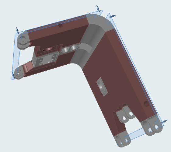

Hi David,
You need to split your design space in different parts. You can then assign a different draw direction to each of your sub-design space :
<?xml version="1.0" encoding="UTF-8"?>
Thanks Mr. Pupat,
In my case my design space is only one part. But I understand that I have to subdivide it, and I did so /emoticons/default_smile.png' srcset='/emoticons/smile@2x.png 2x' title=':)' width='20'>
