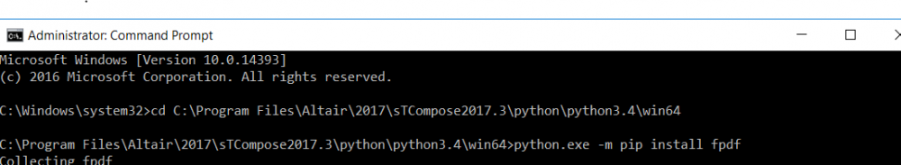

we don’t support creating of PDF and PPTX from COMPOSE OML in 2017.3, these features are coming up in next releases. We can leverage COMPOSE – Python (2way bridge) to accomplish this task.
below are the steps with example:
for i =1:10
f=figure(i);
plot(rand(1,100));
saveas(f, ['demo',num2str(i),'.png']);
end
outfile = 'mypdf.pdf';
exporttopython('outfile','outfile');
evalpythonfile('python_pdf.py'); % comments are added in the file for better understanding.
Hope this helps.
