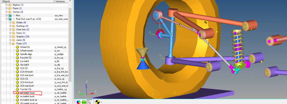

Hello, I am using a template of the Formula SAE cars. And I am performing some analysis on the suspension. And I am having problems with the model.
I am performing a kinematic analysis of the rear suspension. And when I change the outer toelink hardpoint (mainly the y coordinate) the static toe angle is also changing. And with the static wheel aligment toe set to zero the toe angle with no wheel displacement is not zero.
I am not having the same issue in the front suspension template. Only on the rear.
The image is just to show what hardpoint I am talking about.
