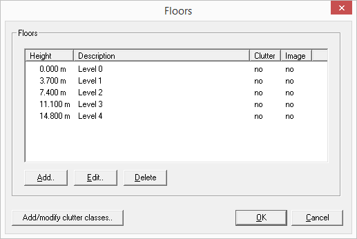

In order to compute in ProMan the results on all the floors (with defined relative height above each floor level) you need in WallMan also to define the floor heights (under Edit => Floors), e.g. for a building database with 5 floors, and then save the *.idb file in WallMan:
