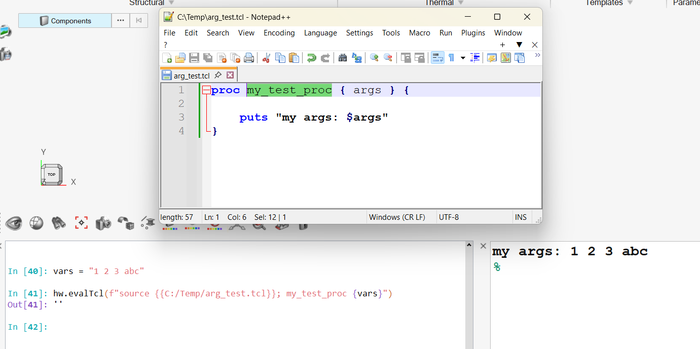

Hi @Alaam
Subprocess will spin-off a completely independent instance of the Tcl interpreter which will not be aware of the HyperMesh session and its APIs.
Since Tcl's source does not support passing arguments to the script, probably the easiest way would be to restructure your code in a way that you can pass the arguments to a top-level function which then calls the rest of our code (see screenshot below).
Hope this helps.
Thanks,
Michal Stefuca
