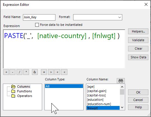

Currently, the easiest way to do it is to do it over two steps, firstly using the Variable Transformation node to concatenate or paste fields:
Here's an example using paste, but you could also use concat.
Then use this 'join_key' as the join key for the merge and complete the rest of the wizard.
