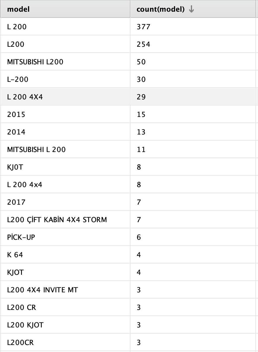

I am working on a very messy dataset. As you look above, models L200, L 200, MITSUBISHI L200 etc. (I mean all of them) are the same model of a brand. I would like to replace any value that has "200" with "L200".
ex  value  - --------------------- -new value
MITSUBISHI L 200              -L200
L 200                                    -L200
L200 4x4                              -L200
so on.
is there any easy way of doing it?

    Hey @dedeer ,
    You can use Generate attributes to create a cleaned attribute as following. If it just few cases that you want to clean.
    if(contains(model,"200"),"L200",model)
    Also, you can explore regex with Replace operator for a more generalized solution.
