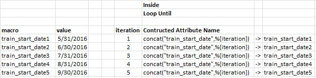

Hi All (@lionelderkrikor )-
There's a 'Set Macros from Example set' operator. Like in the attached process (with excel source file), I'd like to feed macro names and values into the process and then, in a 'Loop Until' operator, access the value of a macro whose name I construct (from another macro).
So, as in the example below, I have a 'train_start_date1' attribute with a value. In the loop, I want to take the string 'train_start_date', stick the iteration number on the end (%{iteration}), form a macro name 'train_start_date1' and then have access to the value of that macro (namely 5/31/2016).
Any help appreciated! Thanks.
-Noel

    hi @Noel ok been scratching my head for 5 min trying to figure out what the problem is. 😀Is this what you're looking for?

    Hi @kayman -
    Thanks for your response. Did you have a chance to look at the process I uploaded, because I’m not sure what the difference is between what you suggested and what I was trying to do.
    The crux of the matter is that I want to be absolutely sure the macro values agree with the number of the iteration running. That’s why I was trying to concatenate the iteration number onto a string. I can’t figure out how to reference the value of the macro whose name is the same as the resulting string...

    Hi Scott- Appreciate the help! You nailed it. Thanks, much.
