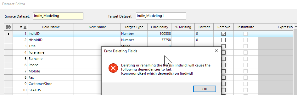

2. Leaving the 'Force data to be instantiated' unchecked, create this variable and then try to delete the capital-gain or capital-loss variables:
3. Note the error saying that you have a dependency on those two variables:
