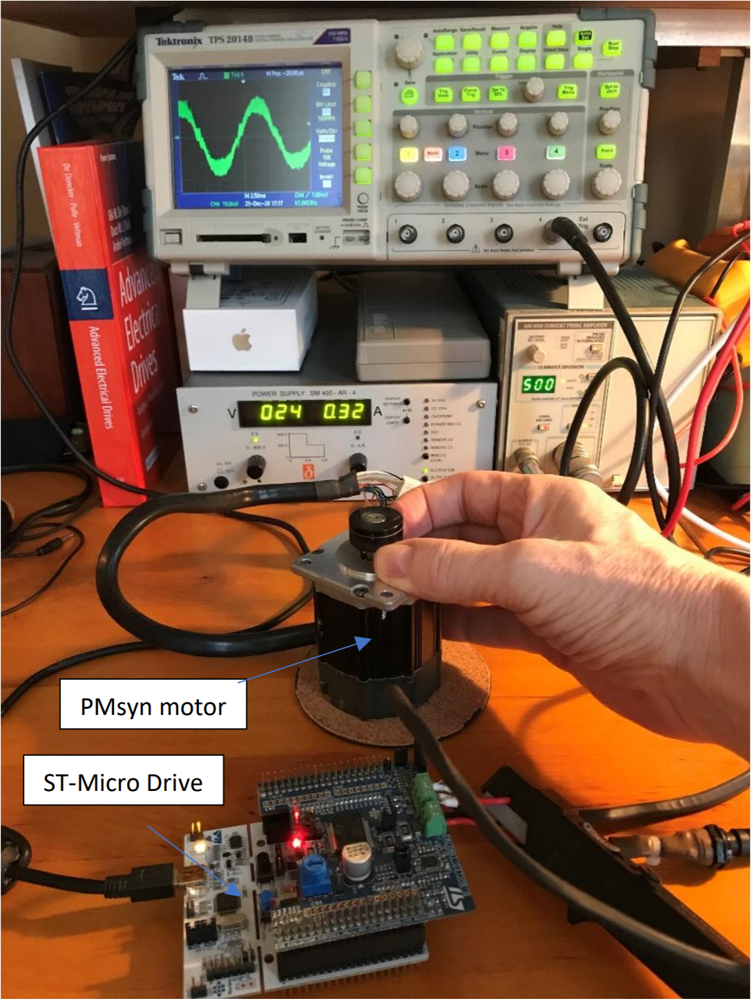

A practical embodiment of the AC drive shown below and consists of an PMsyn Teknic Motor is shown below for the ST-Micro application. It consists of an STM32 Nucleo-64 board interfaced with an 8-48V/2.8A three-phase brushless motor driver that is connected to the Teknic motor. Real-time embedded control from Embed is used to fully control the electrical drive. Because the maximum converter current is well below the maxim motor current, the speed controller should be limited to 2.5A.
STM32 Nucleo-64 board with three-phase driver and PM Teknic motor

The experimental FOC setup shown below shows the ST-Micro drive connected via a USB cable to the laptop that runs the Embed diagram shown above.
A current probe is used to show the measured phase current on the scope, with the drive operating under the same conditions (use of applied hand load) shown in the run-file above.
Experimental FOC setup
