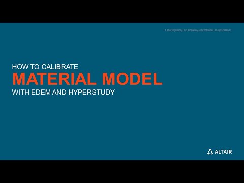

    Thank you for the advice, however the adaptability between EDEM and HyperStudy is not idealized, and the link pointed to a empty website.
    HyperStudy 2022.0/2022.1/2022.3/2023.0/2023.1/2024.0 all do not have EDEM option when adding new model, not as same as the tutorial video (https://www.youtube.com/watch?v=HuO91mCMmjo).

    Hi Qin
    Unfortunately, EDEM is not a native solver for HyperStudy as of now. Please refer to this link for connection between EDEM and HyperStudy: https://community.altair.com/community/en/edem-hyperstudy-connector-installers-and-user-guide?id=kb_article&sysparm_article=KB0122022
